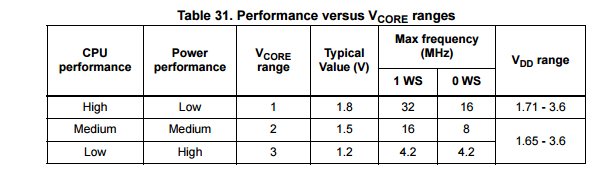

An embedded linear voltage regulator supplies all the digital circuitries except for the Standby circuitry. The regulator output voltage (VCORE) can be programmed by software to three different ranges:
Range 1 (VDD range limited to 1.71-3.6 V), with the CPU running at up to 32 MHz
Range 2 (full VDD range), with a maximum CPU frequency of 16 MHz
Range 3 (full VDD range), with a maximum CPU frequency limited to 4.2 MHz
