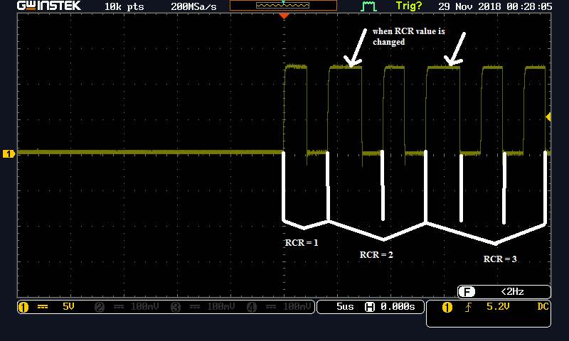

I am developing a motor control application for a servo that is controlled in impulses. So, in my case, the number of impulses represents the number of steps.
For that, I am using the TIM1 in PWM mode using One-Pulse. To account for the number of steps/impulses I use the RCR. To change the RCR val I set the corresponding bit of EGR to generate an update of the TIM1 registers.
The problem arises when I want to generate a small PWM period (4 us in the figure above) I have created a small trial application to test the functionality of my approach. So, I am generating 3 sequences of impulses using 3 different values (0, 1 and 2) for RCR. Because the RCR val corresponds to RCR+1 pulses, the result has to be 6 impulses, which is achieved. However this result is not good because when the RCR value is updated, a delay is introduced. See the picture below.
To accomplish this task I used interrupts for update events, namely:
The hardware is a prototype board designed around the microcontroller STM32F103C8T. Other things important to mention:

{Finally, I somehow would like to update the RCR and TIM1 registers without treat the first update interrupt from above. I belive, there I lose time...
Thank you for your attention and I look forward for some advises. Se the code from interrupt service routine below:
