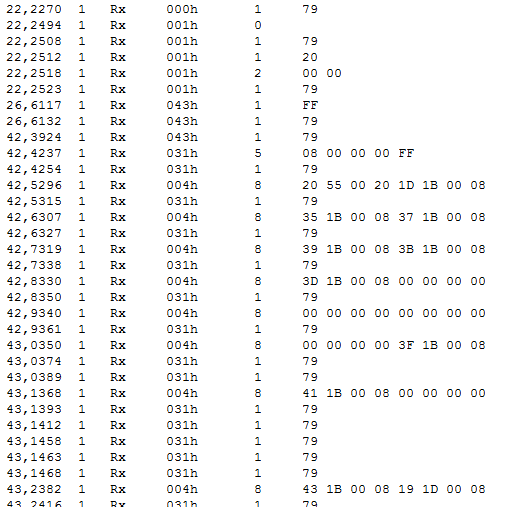

The problem is as follows:
sometimes during transmission the STM32F7 repeats its ACK message several times without having received data again. The data before the ACK messages are also written to memory just as often.

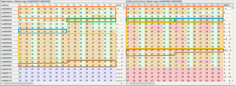

The following pictures show the transmission and the read-out memory after the transmission:
The first 6 frames (6x8 Byte / 48 Byte @ 0x..00 to 0x..2F) were written correctly. The 6th frame was written twice into the memory (correctly @ 0x..28 and @ 0x..30) and the following frames were shifted by one frame size. This is repeated at irregular intervals and with several bytes of shifting.
