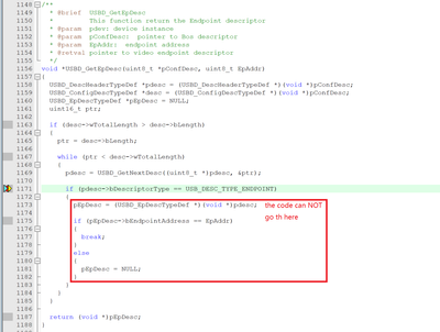

Hi, @Tesla DeLorean
I have read the example and this tutorial carefully.
But my program always can't work, the code is stopped at USBD_GetEpDesc() because pdesc->bDescriptorType always NOT equals to USB_DESC_TYPE_ENDPOINT
I am not skillful at USB, but I can sure the hardware is work well, as I have a project can do that thins.
If need, refer my project at attachment.
Thanks for your help!
