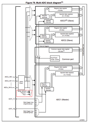

You need to refer to the reference manual of the product RM0390 / figure 79
As you can see some ADC inputs (Temperature sensor, Vref, VBAT) are connected internally and not exposed on pins.
