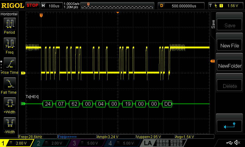

Below is a scope capture of the 10 bytes of serial data:

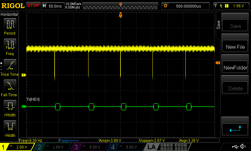

Below is a scope capture of the 10 bytes of serial data being sent at a 100ms rate:

Its as if I need to monitor the serial line with a timer, in order to detect the period when the serial line is high for say 50ms and use this timer to enable and disable the UART peripheral. But there must be a better way to do this ?

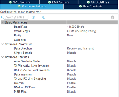

The UART is configured as shown below and the rx buffer is a size of 10.
The 10 bytes are transmitted by a electronic speed controller, used for radio control applications and contains the following data:
Byte 0: Temperature
Byte 1: Voltage high byte
Byte 2: Voltage low byte
Byte 3: Current high byte
Byte 4: Current low byte
Byte 5: Consumption high byte
Byte 6: Consumption low byte
Byte 7: Rpm high byte
Byte 8: Rpm low byte
Byte 9: 8-bit CRC

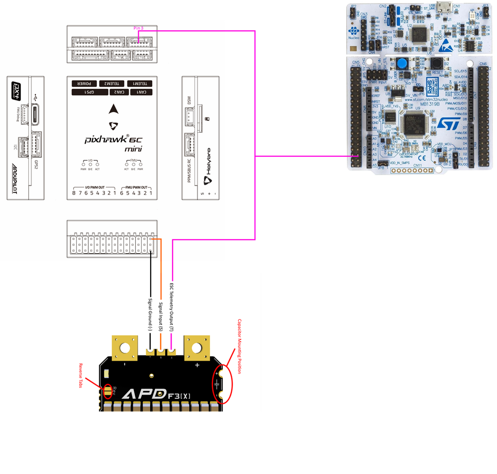

The telemetry request is performed by a flight controller, in this case a Pixhawk 6C mini and in this case using a protocol called DSHOT (for some reason RC seems to use non-standard protocols :face_with_rolling_eyes:).
The flight controller sends the DSHOT message which requests the telemetry data.
My datalogger has to then listen for the telemetry data response (from the ESC) and store the data to an SD card.
