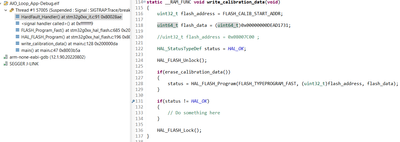

I am observing Hardfault exception when trying to program internal flash of stm32g030k6t6 MCU in FAST mode . is there anyother FLASH registers i need to enable ?
I have attached the code here

status = HAL_FLASH_Program(FLASH_TYPEPROGRAM_FAST, (uint32_t)flash_address, (uint64_t)0xDEAD1731);
HAL_FLASH_Lock();

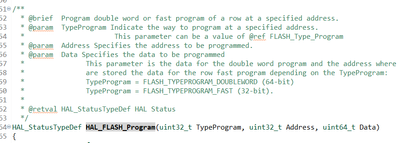

That's still an invalid argument. Why do you want to use FLASH_TYPEPROGRAM_FAST? Your use case is clearly better suited to FLASH_TYPEPROGRAM_DOUBLEWORD as you aren't programming 256 bytes.
This is a bogus call. 0xDEAD1731 is not the location of 256 bytes of data, as required for fast programming.
Probably you want to stick with FLASH_TYPEPROGRAM_DOUBLEWORD and program 64-bits at a time.

Hello @TDK ,
I am able to save data in Flash with FLASH_TYPEPROGRAM_DOUBLEWORD . but Hard fault exception is still exists even passing arguments correctly with FLASH_TYPEPROGRAM_FAST

2024-02-06 6:29 AM
2024-02-06 9:01 AM
Thank you @TDK . I will check the example code for fast programming . i just wanted to understand about it
