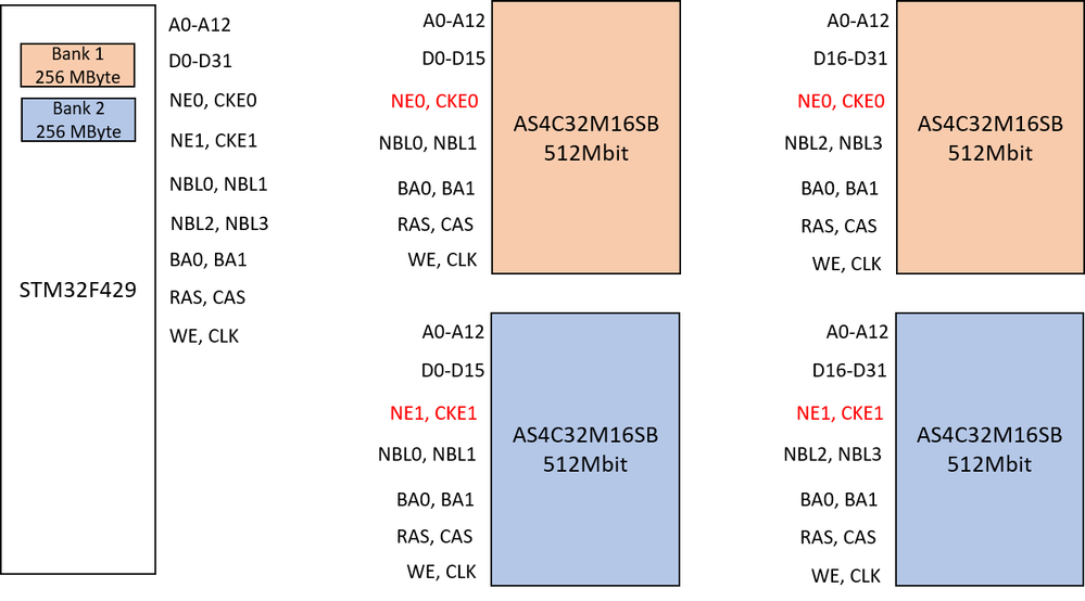

2022-07-21 11:47 PM
For total 2 Gbit SDRAM, is this configuration OK? Also, if I want to use 4 Gbit SDRAM, what should I do?

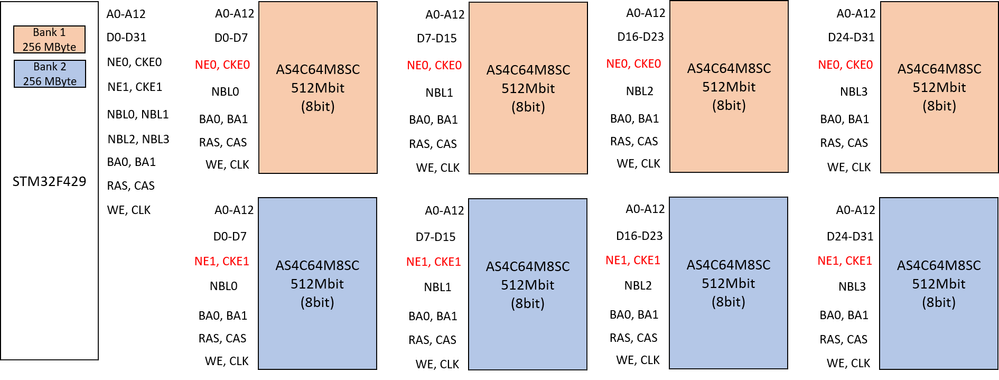

2022-07-22 5:31 AM
For total 4 Gbit SDRAM, is this configuration OK?
