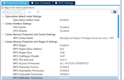

After correcting the flash and SDRAM sizes, it still won't program. Even after changing the MCU permissions for memory protection. So to me that clarifies that an external bootloader is needed?

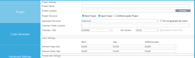

2026-02-04 3:12 AM - edited 2026-02-04 3:14 AM
I do not get 'Boot Project', 'Appli Project', and 'ExtMemLoader Project' under project structure when selecting STM32H750IBT6 as my MCU.
This is what I see with a blank project and also with importing the IOC into STM32CubeMX, after selecting STM32H750IBT6.
'Boot Project', 'Appli Project', and 'ExtMemLoader Project' do appear when selecting STM32H7S7L8H6H.
Please advise me further, thank you.

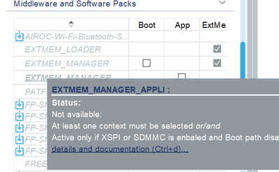

2026-02-04 3:20 AM - edited 2026-02-04 3:21 AM
It looks like you need SDMMC or XSPI available to access the middleware needed (from looking at STM32H7S7L8H6H). I do not believe this method, described in https://wiki.st.com/stm32mcu/wiki/Getting_started_with_External_memory_Manager_and_External_memory_loader#STM32CubeMX_FlashLess_Application_Configuration, is compatible with STM32H750IBT6?
