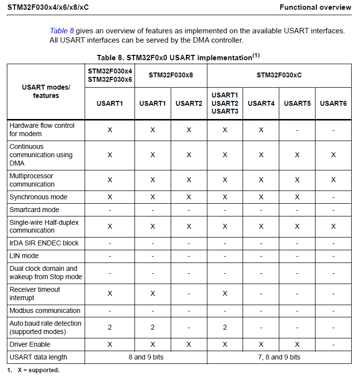

@Johi "use the fifo's in the UART"
Does an STM32F030R8T6 have any FIFOs in the UART?
