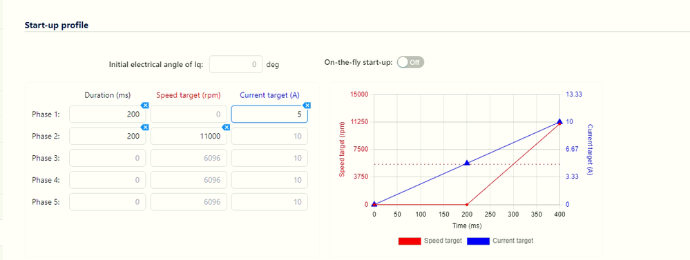

I'm using a custom STSPINF0 based board and successfully profiled my motor. Using motor pilot, I have obtained a start-up profile which I've also implemented in Motor Control Workbench (6.3.1) as shown below:
I've interfaced STSPINF0 with nRF52832 over USART and I'm able to execute commands & receive data successfully.
But, motor runs and stalls with Fault_over/ Duration type fault when I execute MC_StartMotor1(). I think using this command my start-up parameters are not executed.
I want to know does Motor Workbench stored my start-up parameters in the firmware/ STM Cube IDE? If so, how I can start my motor using that stored start-up parameters?
Otherwise, please guide me how can I manually implement & execute my above start-up parameters in forms of following commands before executing MC_StartMotor1() over USART:
* - MC_ProgramSpeedRampMotor1()
* - MC_ProgramTorqueRampMotor1()
* - MC_SetCurrentReferenceMotor1()
Thanks

2025-11-18 3:03 AM
OK, I have been searching out and I see that my start-up has been saved in RevUpControlM1 handle.
So, does this mean that MC_StartMotor1() starts my motor using above handle? Executing my saved ramp?
If no, what is the correct procedure to call that handle "RUC_Exec(&RevUpControlM1);"?
If yes, then why Motor Pilot works to start my motor but MC_StartMotor1() does not?
My motor runs up to set motor RPM of 11000 but then goes into fault error no. 11 (duration).
What is the solution?
Thanks
