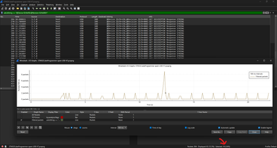

After Click Erasing & Programming tab. Program send Get ID for 100 packets per sec

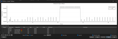

Graph with 1 Sec interval, Get ID packets (I only filter 0x02)
Graph with 100ms interval, Get ID packets
Before Click, 2 Get ID per 1 sec
After Click, 513 Get ID packets with no delay

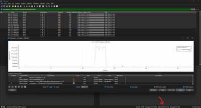

I also try with FTDI and result is mostly same
Graph with 100ms interval, Get ID packets 6-7 packet per 100ms
And also 513 packets

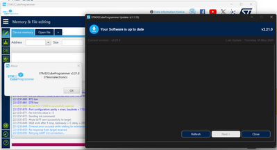

I use STM32CubeProgrammer v2.21.0
I try to set log Verbosity level to level 3. But program freeze more than 30 minutes. So, I kill program.

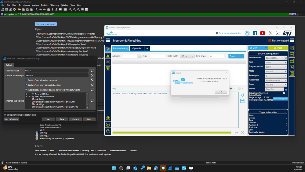

MCU: L476VG

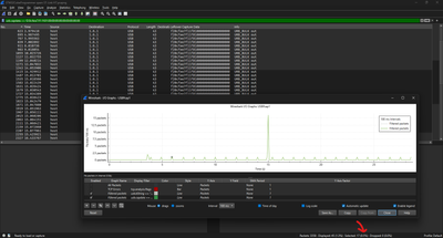

I don't know how to decode USB package. So, I filter using `f2:0c:fe:6f:ff:1f:01:00:00:00:00:00:00:00:00:00` This look like send every 1 sec. And behavior look like UART have 513 packets after click Erasing & Programming tab
Board: WeAct Studio STM32H743VIT6-0.96
With SWD I use `f2:0c:fe:e7:f1:1f:01:00:00:00:00:00:00:00:00:00` to filter. I think program only send 17 packets.
With USB DFU System bootloader. Normal send 2 packages per sec. After click I think 18 packets.

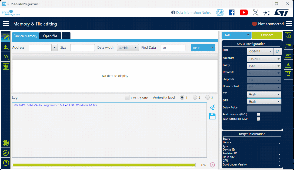

2025-06-03 6:56 PM
Hello @Maryem ,
I test with v2.19.0, L476VG, Windows 11 (24H2) 64-bit build 26100.4202
This problem still happens. ST-Link with >300 packets/sec will freeze for at least 2.5 sec
UART with ~100 packets/sec will freeze for at least 7.4 sec
Thank you.
