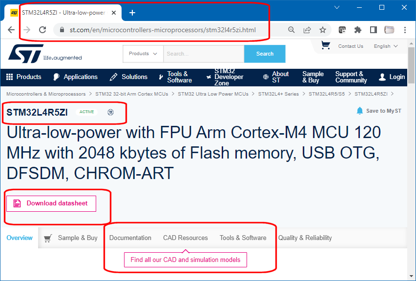

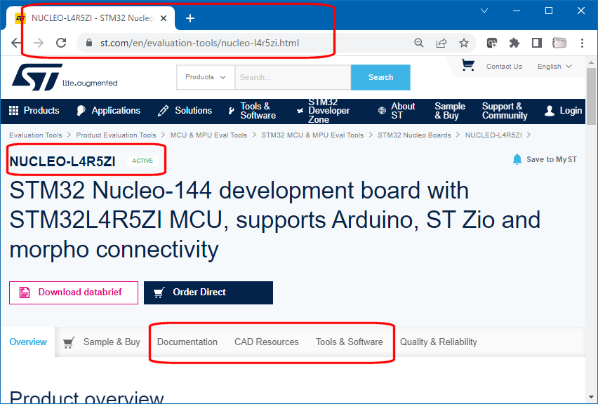

The place to start for all documentation is always the Product Page - there is one for the board:
And one for the chip:
You can easily find the Product Page for a product by just putting its part number - here, eg, "STM32L4R5ZI" and "Nucleo-L4R5ZI" - into google.
