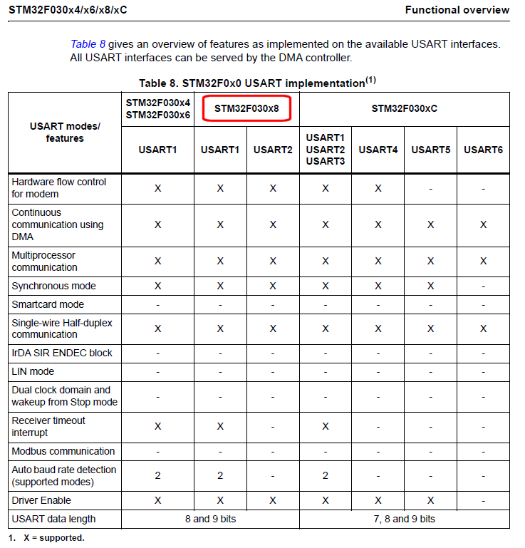

Did you mean STM32F030x8?
Datasheet has no mention of any hardware FIFO for the USART:
So you'd have to implement any FIFO (aka "Ring Buffer" or "Circular Buffer") in software.

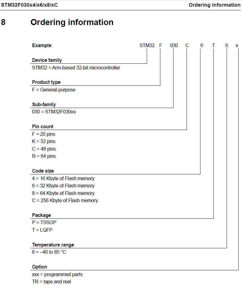

@SSRIN.2 "stm32f0308"
Again, that's not a proper part number - please give the actual part number

@Andrew Neil
''Again, that's not a proper part number - please give the actual part number''
part number is STM32F030R8T6
