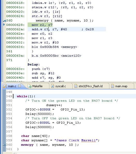

I am trying to run a TCP/IP demo on a Olimex STM32F4 board
with eclipse + yagarto
however I cannot connect to the board with LAN
when I stop the demo with JTAG to look where it hangs
it shows below code
I tried to set up breakpoint before the memcpy function
as shown in the attached picture
It stops at the breakpoint just before the memcpy function
however when I rerun from this point
it ends up at hardfault handler as shown below
please advice how can I proceed ?

Are you sure it doesn't fault because it leaves main()? Where does it go then?
Try putting a while(1); at the end so it stays within main()2012-12-19 1:26 AM

of course I have memcpy inside infinite loop I omitted it for simplicity of the message the micro still goes into hardfault when it sees memcpy how much simpler can a memcpy command be ( previous post ) ? I suspect that the linkerscript is somehow bad can you please comment on my linkerscript ? thanks2012-12-19 2:19 AM
Is it possible that you link to a wrong library ?
If the library code contains ARM32 instructions, it will surely hardfault. Make sure you link to a THUMB/THUMB2 library.2012-12-19 4:26 AM
If in doubt disassemble the code. I don't think the linker script is the issue.

The ''blx 0x800B584'' is indicative of a call to 32-bit ARM code, you could look at 0x800B584 to confirm this. This would suggest your linker is pulling in 32-bit libraries (ARM7/ARM9) instead of the 16-bit Thumb libraries.
The 16-bit memcpy should look a bit like this, from my .LSS listing file08000188 <

2012-12-22 9:35 AM
Hello Clive ,
you are really a great person I added below switches to linker command line and the program linked succesfully with correct library before : LDFLAGS=
-g -v -nostartfilesnow : LDFLAGS
mcpu
=cortex-m3 -mthumb -g -v -nostartfiles and the TCP / IP demo run succesfully - I can connect to my Olimex STM32-E407 board through LAN thank you and other who replied to my postWe’re moving the ST Community to a new platform to give you a better and more reliable community experience.
