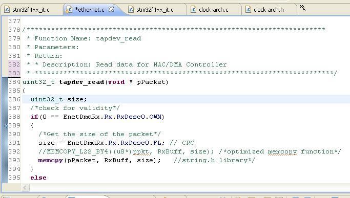

I tried to set up breakpoint before the memcpy function
as shown in the attached picture
It stops at the breakpoint just before the memcpy function
however when I rerun from this point
it ends up at hardfault handler as shown below
please advice how can I proceed ?
Of course it does. It does not make a difference if you made an intermediate stop.
Step into the memcpy function. Check that both source and target are proper locations in RAM, and that size does not exceed your bufffer size. It would be a ggod idea to check this before calling memcpy(), at least in the development phase. Your hardfault might well be caused by a stack overflow. Check that your stacksize can handle the buffers you define.

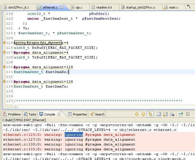

hello forum thank you for the answers
when I tried to compile the project it compiles however it gives following warning can it have something to do with the above mentioned hardfault error ?2012-12-12 5:45 AM
If you want to define aligned data, you can also use the following define:
#define ALIGN4 __attribute((aligned(4))) char c ALIGN4; char ac[3] ALIGN4; Then c and ac[0] will be address aligned on 4-byte.2012-12-12 6:12 AM
You should add that #pragmas in general are compiler-dependant. They are reserved by the C standard for exactly such implementation-dependant settings. The 'offending' code was probably implementing using another toolchain. When reading of Olimex, I guess it was IAR.__attribute is the usual gcc method.

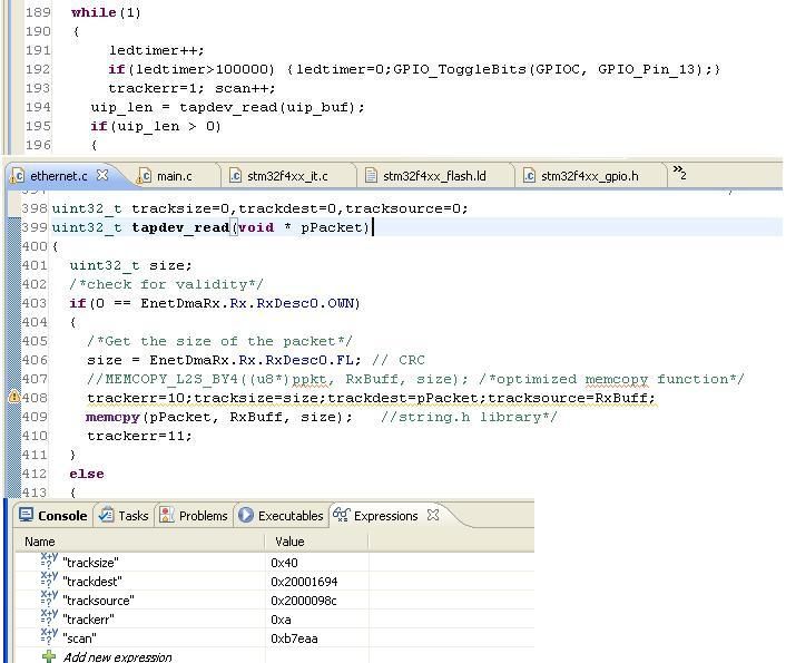

hello forum,
I made a trap in my code and see where the code hangs ( hardfault handler ) as you can see in the picture the code was at the memcpy function just before the hardfault handler becouse the trackerr stops at value 10 I set other variables to see what the dest, source and size variables value are just before the memcpy was called lastly I set a scan variable which counts the scan count at the time of where the code hangs this scan count takes different values like 0x95a85 , 0xb7eaa , 0x423e each time I run the code from the start it last about 1- 2 sec before the code hangs - as you can see I set a blink led ( 1 Hz ) in the infinite loop - I see only blinking 2 - 3 times before the led freezes what do you suggest me to look at ? thank you2012-12-16 12:23 PM
Well obviously you should perhaps start by looking at the uip_buf, how big it is, and how it's situation with respect to the stack. You should be looking at the processor registers, and disassembly of the code that is actually faulting. This might at least allow you to see if the fault is due to the copy, or that the LR or stack are being compromised. Until you know exactly what the processor state is you're going to keep drowning. Get a precise idea of what's wrong, and work backward. Ask yourself how the system arrived at the condition, and what code it travelled through to get there.We’re moving the ST Community to a new platform to give you a better and more reliable community experience.
