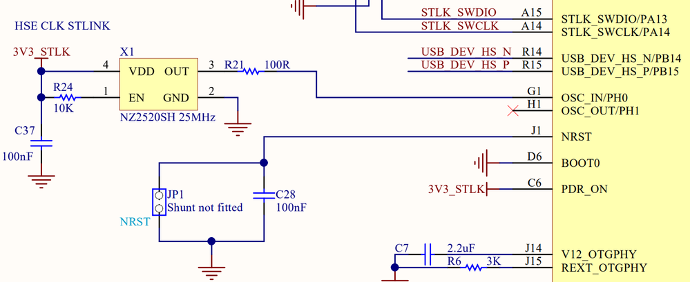

2021-11-18 6:01 AM
Here is an example link for the HSE oscillator.
from https://www.st.com/resource/en/schematic_pack/mb1364-h753zi-c01_schematic.pdf
there are different combinations in the reference designs. you can study reference designs and learn a lot

2021-11-18 6:08 AM
Hello Muhammed, thank you very much. That is what i am looking for.
Best regards
Ulrich

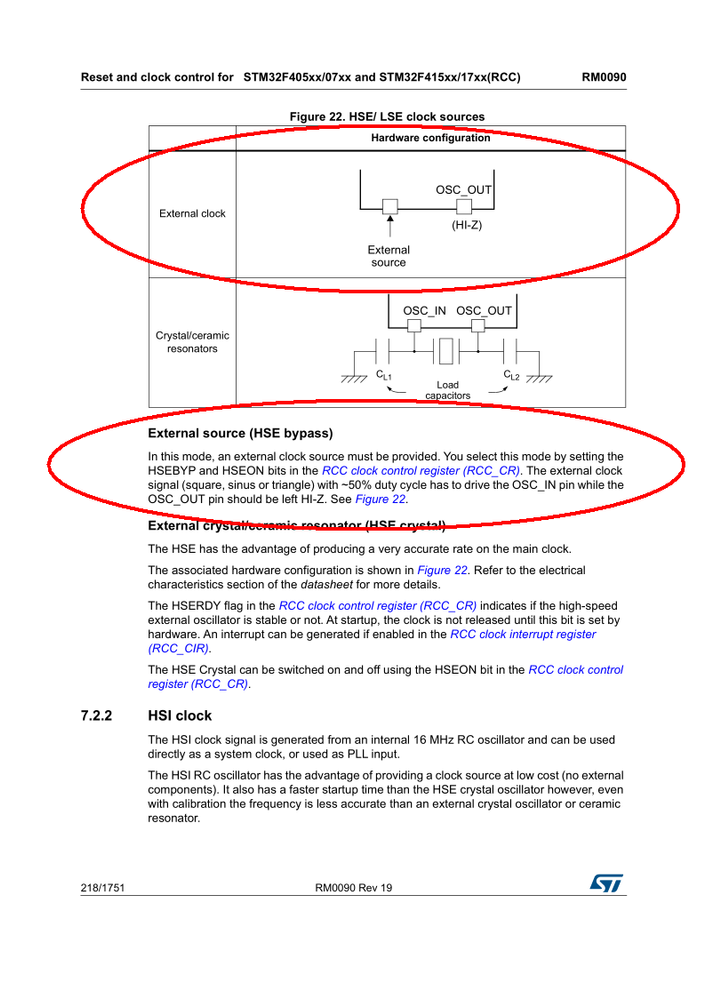

2021-11-18 6:12 AM
You can use a clock signal as the input to HSE by putting it in "HSE BYPASS" mode and piping the signal into OSC_IN as in the schematic above.

2021-11-18 6:41 AM
For this project a STM32F407.
Thank you very much. I have read a lot of the stm32 original documents and contributions from other user published in the www, but i have overseen this.
