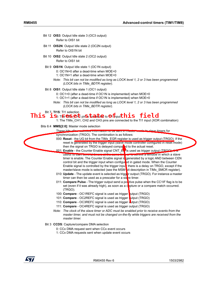

After tracing the HAL code, I find that at the time of software generate update event, all the trigger sources are in HW reset state. TRGO/TRGO2 trigger event sources have not been configured but trigger signal exist on TRGO/TRGO2.
I want to know who generate it ? how to avoid?

Only initialized timer Clock Division,ARR, counter mode, then raise an update event, I get TRGO/TRGO2 trigger.
2021-11-18 6:26 AM
2021-11-18 6:45 AM
Got it. Thanks a lot.
It means at the HW reset state, timer will generate TRGO signal whenever by UG event.
