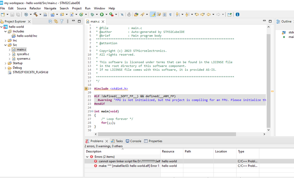

Does the path to the linker have non-ascii characters in it?
2023-06-09 9:52 AM
Doesn't look like a usable path.
Avoid Hieroglyphs and Pictograms, and use simple paths with Western characters.
2023-06-11 2:34 AM
how can i change the path of the linker ,please?
2023-06-11 2:35 AM
2023-06-11 3:19 AM
You edit it in the project settings -> Tool settings -> Linker
2023-06-11 9:26 AM
there is no project settings in my ide ,i run ide version 1.12.1!!!
