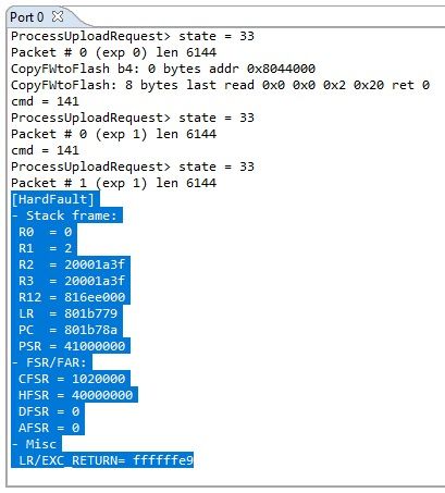

Here's the output:
I'm writing on page boundaries and I always write 64 bits at a time (though I see that the HAL function can be easily adapted to write 32 bits).
Even when I just write 16 bytes, it breaks in the HardFault_Handler.
If I enter the function with the debugger and step over each line, including if(HAL_FLASH_Program(FLASH_TYPEPROGRAM_DOUBLEWORD, flash_ptr, dataf) == HAL_OK)
then burning to the flash succeeds. I suspect something to do with clocks or other peripherals.
I wrote bootloader code successfully - but except for one GPIO to show a blinking LED, the bootloader uses all of the STM's defaults on power-up.
Now I'm in the part of the code in which I receive the new FW to be burned over RS485 communication, and write it in the 2nd half of the flash (from 0x8044000 until 0x807FFFF). Even though I disable all interrupts, something is not allowing the flash to be burned correctly.
Whatever light you can shed on this would be appreciated.
Thanks,
Mechi
2019-03-10 7:06 AM
The dump is helpful - I'm checking the code around LR and PC...
2019-03-10 7:40 AM
And an alignment error it was...
I tried to cast a BYTE array to a 64-byte pointer.
Now with the memcpy to a 64-bit variable (without the cast, there is no HardFault.
