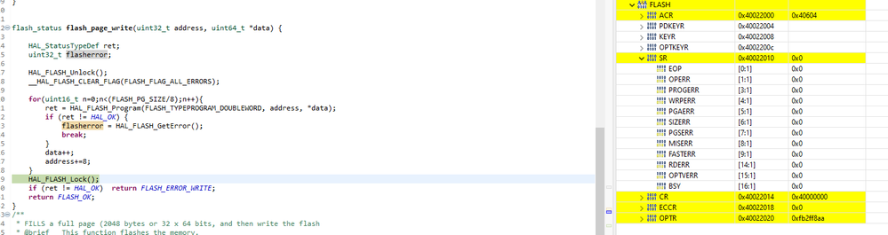

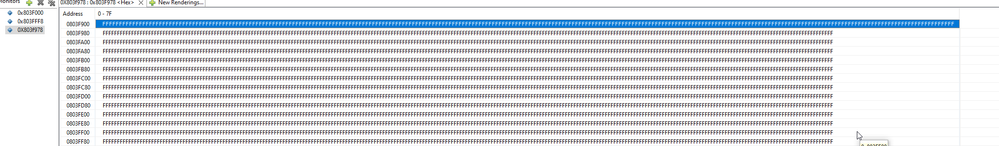

This seems to fail somewhere randomly in the for loop of flash_page_write() ) .
When it fails the HAL function fails and HAL_FLASH_GetError() returns 0x40 which is size error ?
How can this happen when data and address is still well within the boundary?

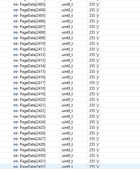

During debugging i found these locations when entering flash_page_write
PageData (0x20003660)
address (0x803f000)
