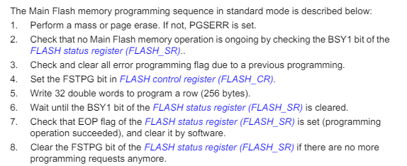

In the Reference Manual RM0444 chapter 3.3.8 -> fast programming you can find the sequence needed to perform the block programming you're describing. It includes the FSTPG bit set before the programming :
You can either reproduce the sequence on your own, or use the function FLASH_Program_Fast() that will set the FSTPG bit, program the 32 double-words, and wait until the BSY1 bit is cleared (you still need to perform the other elements of the sequence described in the Reference Manual in order to do a proper programming).
