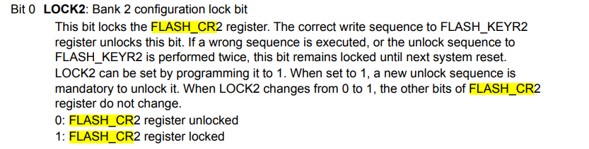

For the FLASH_CR_SNECCERRIE and FLASH_CR_DBECCERRIE interrupts to be effective, the LOCK2 bit should be cleared to 0.
Check:
