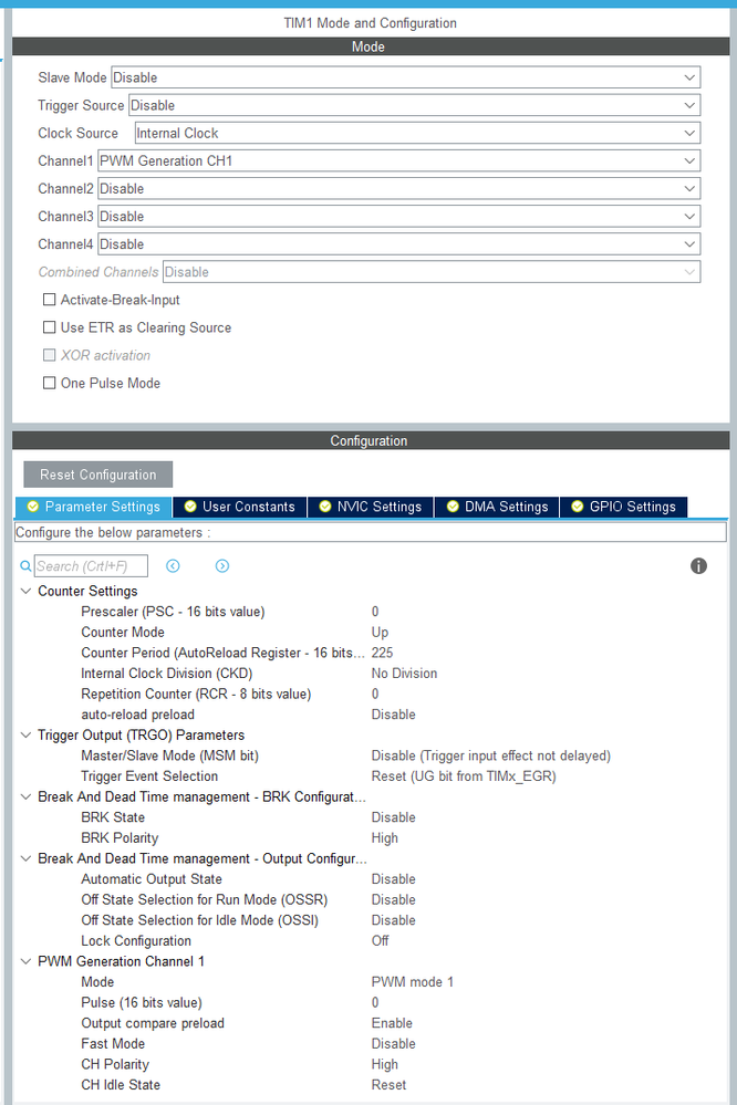

To realise this concept (which is valid or isn't it?) I used the STM32CubeIDE with STM32CubeMX.
In CubeMX I configured TIM1 to be clocked at around 800kHz by setting no prescaler, a Counter Period of 225, setting Channel1 to PWM_Generation_CH1 with PWM_Mode_1.

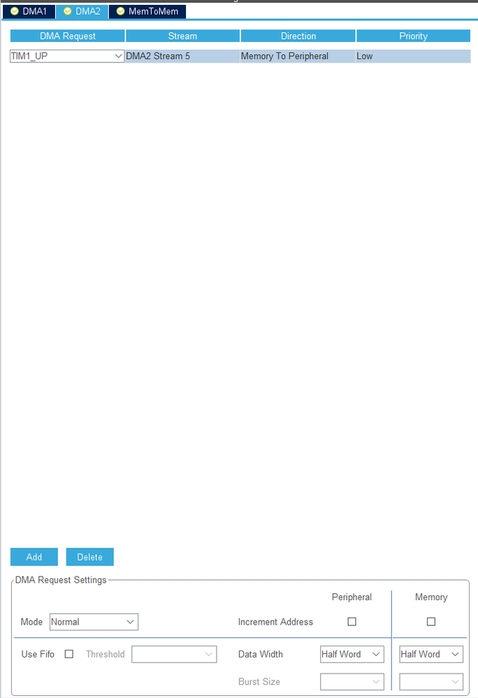

For DMA I added a request triggered by TIM1_UP from Memory to Peripheral with a data width of half_word.
The CubeMX settings are also visible in the pictures of it:

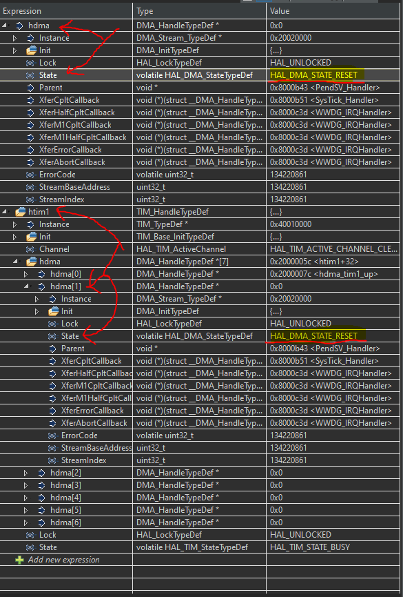

I traced the origin of the return value HAL_ERROR:
HAL_TIM_PWM_Start_DMA is calling HAL_DMA_Start_IT.
If HAL_DMA_Start_IT doesn't return HAL_OK, HAL_TIM_PWM_Start_DMA returns HAL_ERROR.
In my case, HAL_DMA_Start_IT returns HAL_BUSY. This is due to its hdma->State not being HAL_DMA_STATE_READY.
I checked and instead of that, hdma->State is HAL_DMA_STATE_RESET.
So, htim1.hdma[1].State is HAL_DMA_STATE_RESET, when calling HAL_TIM_PWM_Start_DMA; In HAL_TIM_PWM_Start_DMA htim1.hdma[1] is passed to HAL_DMA_Start_IT as the argument hdma.
The described tracing above is also visible through the source of these functions and the attached image of the debugged TypeDef values:

}I tried to figure out, why htim1.hdma[1].State is stuck on HAL_DMA_STATE_RESET and what might be wrong or missing, tried also different functions like HAL_TIM_OC_Start_DMA or HAL_TIM_DMABurst_WriteStart.

HAL_DMA_STATE_RESET indicates the DMA has not been initialized.
There should be a call to HAL_DMA_Init within HAL_TIM_Base_MspInit which will initialize the DMA. CubeMX should generate this code for you within "stm32f4xx_hal_msp.c".
2020-07-29 2:00 PM
I think the underlying issue is you have DMA set up for the update event, not for the CH1. When you add a DMA request, select TIMx_CH1 instead of TIMx_UP.
2020-07-29 2:24 PM

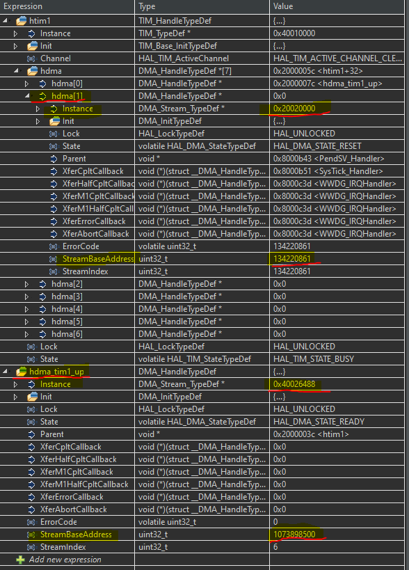

Thank You for your quick reply.
I checked and there is indeed a call to HAL_DMA_Init within HAL_TIM_Base_MspInit, which also gets called on startup.
However there is one thing that seems wrong/weird to me.
When looking at the source of HAL_TIM_Base_MspInit, more specifically the call to HAL_DMA_Init, the argument being passed to HAL_DMA_Init startles me:
if (HAL_DMA_Init(&hdma_tim1_up) != HAL_OK)
Error_Handler();
}The argument hdma_tim1_up is not the same as htim1.hdma[1], which causes the problem.
These are the TypeDef values of hdma_tim1_up and htim1.hdma[1]:
From looking at the Instance value and the StreamBaseAdress I would assume they are not the same or am I wrong?
From looking at the debugged TypeDef values, hdma_tim1_up.State seems so be HAL_DMA_STATE_READY, while htim1.hdma[1].State is HAL_DMA_STATE_RESET.
Do You understand this?

2020-07-29 2:53 PM
Thank you for the reply.
This looks quite promising, I am currently testing it and it works so far.
However, it confuses me, since the DMA Request/Transfer should occur, when TIM1 overflows (hence TIM1_UP), and not when CH1 matches.
I will test which is the case but the name of the request "CH1" hints to be when CH1 matches, which would be wrong for my principle.
I will test, which it is or alternatively, can you tell me/do you know?
2020-07-29 3:03 PM
Ok, it seems to be triggered when CH1 matches... But I need it to trigger when TIM1 overflows. How would that be achieved?
