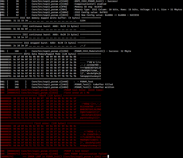

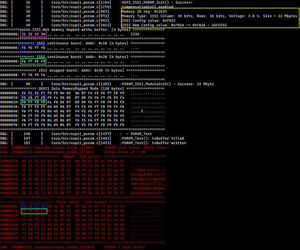

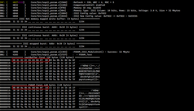

I can read the ID and configuration registers, I can also modify them (Yellow square), but when I write directly or indirectly to the memory area, and read back for verification, it causes an error.
I tried to change the OSPI speed, using 55, 80, 100 MHz (with recalculated refresh rate using 4us tCEM: 220, 320, 400, 640), with- or without delay block, DHQC enabled/disabled (I know the errata), and DQS values, etc., but didn't work, except that some settings were totally wrong for configuration registers.
I don't know exactly what the error is: writing to memory area or reading it.
My biggest success is that I can read the same data from the same address in both memory mapped mode and normal mode (blue and green squares), but this data is not the same as what I wrote (pink square).

2025-09-19 7:30 AM
Hello @ccuebler ;
Could you please check the dummy cycle?
Is the cache enabled?
For CPU accesses, try to enable ICACHE and/or DCACHE, and configure the OCTOSPI memory as cacheable (CACHE only performs 32-bit read accesses).
I hope this help.
Thank you.
Kaouthar
2025-09-21 11:32 PM
Hi @KDJEM.1 !
Thanks for the answer,
The ICache was always enabled on my fw. I also used DCache in Wrap and Incremental modes, but nothing changed...
I used only ICache With APMemory and it worked perfectly.
Thank You!
Krisztian
2025-09-22 2:36 AM
Hello @ccuebler ;
What about the dummy cycle? Does 5 correspond to the value mentioned in the memory datasheet?
Thank you.
Kaouthar
2025-09-22 4:03 AM
Hello @KDJEM.1
I somehow missed Your question.
I checked again the datasheet of PSRAM, and yes, I only used dummy cycles for read, but it need to writings.
According to the datasheet I'm using 10-10 cycles, and the result is a little closer to My expectations, but not perfect.
In memory mapped mode some data was almost good but not in the right address.
I tried to change the dummy cycles, and refresh time but this was the best result.
About the DCache, You are right, I disabled it last time for a test.
Now, It enabled again in incremental mode
Thank You.

2025-09-23 4:56 AM - edited 2025-09-23 6:46 AM
Hi @KDJEM.1
An addition information:
Now, the direct read / write is good with weird values:
refresh = 320, Write dummy cycle: 4, read dummy cycle: 5
I tried five times with 1024 bytes long buffer, in a different address.
Because it was good, I ran the delay block tuner (https://github.com/STMicroelectronics/STM32CubeU5/tree/main/Projects/B-U585I-IOT02A/Examples/DLYB/DLYB_OSPI_PSRAM_ExhaustiveTuning)
and I use that values :
dlyb_cfg.PhaseSel = 1;
dlyb_cfg.Units = 50;
I test it, but in memory mapped mode not works properly.
More interesting: The readed data shifted by 8 bytes...
I tried with or without DCache.
Have You any idea?
Thank You
Krisztian
