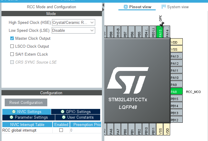

So I've created a project and am trying to use the HAL_delay(10); but it gets stuck at this function when im trying to debug.
I have been changing the clock and enabling the TIM2 so I don't know if i've messed something up. Here are the settings that I have:
And that is about it

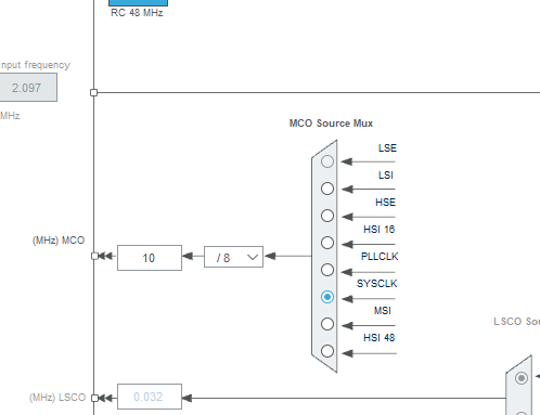

2023-04-17 2:11 AM - edited 2023-11-20 8:06 AM
So with this settings i should expect 10Mhz at PA8?
2023-04-17 2:18 AM
if sysclk 80M ...right.
2023-04-17 2:23 AM
sysclk is 80Mhz yes, but Im not sure how much can gpio handle so I just set it to 10Mhz to be sure it works
2023-04-17 2:49 AM
@AScha.3 It seems to be working fine, so I have no idea what could be the issue

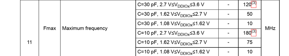

2023-04-17 4:07 AM - edited 2023-11-20 8:06 AM
read in DS , p. 135 . depends on core voltage/speed setting , for high 11 ->
