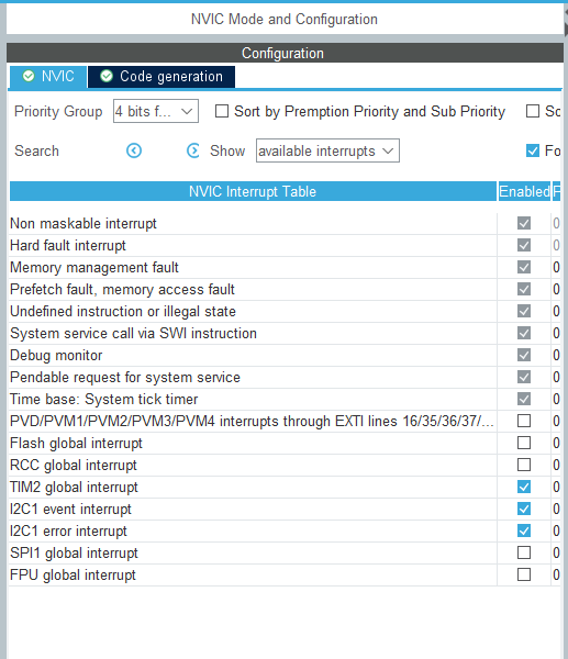

So I've created a project and am trying to use the HAL_delay(10); but it gets stuck at this function when im trying to debug.

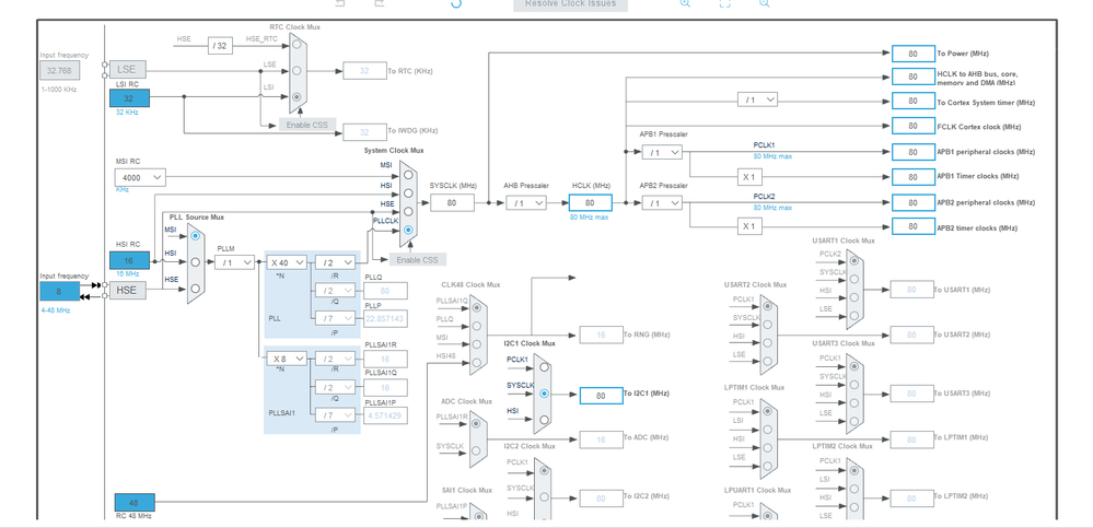

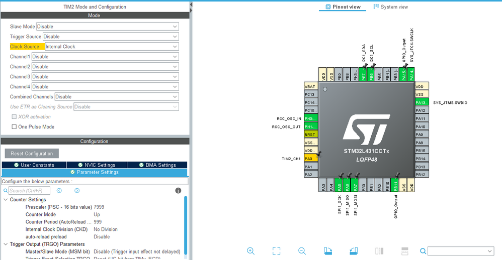

I have been changing the clock and enabling the TIM2 so I don't know if i've messed something up. Here are the settings that I have:
And that is about it

where you call hal-delay? in INT ? you give all ints same (highest) priority 0 , so Systick cannot be called from same level. -> set tim2 2 , i2c..3 or so.

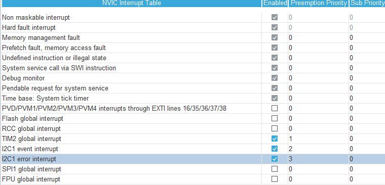

2023-04-16 4:35 AM - edited 2023-11-20 8:04 AM
I changed it like so and it still gets stuck at HAL_delay(10);

ok, in main should be no problem anyway.
try: not jump in/on hal-delay() , set cursor one or more lines after the line with delay and use run -> run to line

just..why not use the hse ?? (and pllm /2)
is program running when just run/start in debug? (and stop with suspend/pause )
2023-04-16 6:10 AM
I tried it with hsi, still not working. Yes, it seems like its running fine but cant really check because the live expression values are not showing for some reason. Also, do I need to do anything in the code to enable delay? I havent done anything, just tried to use it with hal_delay()
