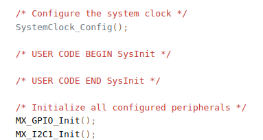

2023-04-16 1:00 PM - edited 2023-11-20 8:05 AM
why is sys-clk-config light grey ?

2023-04-16 1:07 PM
no idea actually, seems normal to me in the editor. I changed theme to black now to see the difference but they all look the same either way
