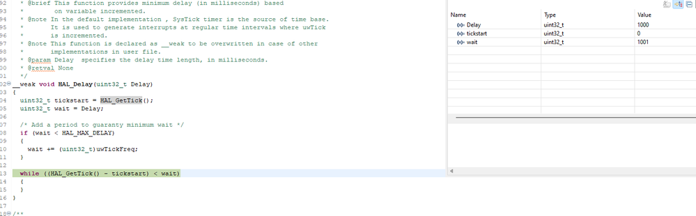

so this is the inside debug of delay:
it gets stuck at this while

2023-04-16 6:52 AM - edited 2023-11-20 8:05 AM
seems: sysclk not running ...because tickstart should not stay at 0.
should be so: (> 0)

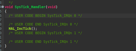

and in ***_it.c file you should have :
