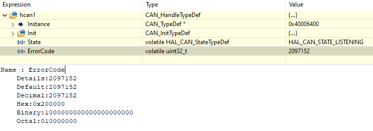

>>After a few transmissions the mailboxes are filled
After how many, always the same number? is that number 3?
2022-12-21 8:11 AM
Yes, I am using the NXP TJA1051T/3
2022-12-21 8:14 AM
Yes, this is always the same number. After 32 messages, this errorcode occurs in the can handler.
