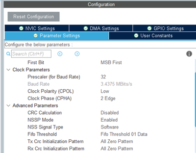

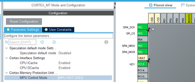

I has been devloping an ECG program with ADS1292R and STM32H723VGT6.I has been struggling with a problem.
The ADS1292R uses SPI and it's register can be read if I use STM32C8T6 which configuerd by libray finction.But when I configuer program with H723,the question is coming-----my H723 can't read the registers of H723.I've checked the datasheet of ADS1292R over an over again,and also asked TI support for help, I can promise that there are no faluts about the configuration of ADS1292.So the problem must be in the configuration of SPI.After debugging ,I noticed that the receive cache has been empty when I tried to read the registers of my SPI device.I really don't know why,it seemed that there wasn't changes of SCLK's wave when the command coming.I've enable the spi but it was useless.I really can't undersantand and don't know where the errors being.Plead help me and check my code.
void MX_SPI4_Init(void)
/* USER CODE BEGIN SPI4_Init 0 */
/* USER CODE END SPI4_Init 0 */
/* USER CODE BEGIN SPI4_Init 1 */
/* USER CODE END SPI4_Init 1 */
hspi4.Instance = SPI4;
hspi4.Init.Mode = SPI_MODE_MASTER;
hspi4.Init.Direction = SPI_DIRECTION_2LINES;
hspi4.Init.DataSize = SPI_DATASIZE_8BIT;
hspi4.Init.CLKPolarity = SPI_POLARITY_LOW;
hspi4.Init.CLKPhase = SPI_PHASE_2EDGE;
hspi4.Init.NSS = SPI_NSS_SOFT;
hspi4.Init.BaudRatePrescaler = SPI_BAUDRATEPRESCALER_32;
hspi4.Init.FirstBit = SPI_FIRSTBIT_MSB;
hspi4.Init.TIMode = SPI_TIMODE_DISABLE;
hspi4.Init.CRCCalculation = SPI_CRCCALCULATION_DISABLE;
hspi4.Init.CRCPolynomial = 0x0;
hspi4.Init.NSSPMode = SPI_NSS_PULSE_ENABLE;
hspi4.Init.NSSPolarity = SPI_NSS_POLARITY_LOW;
hspi4.Init.FifoThreshold = SPI_FIFO_THRESHOLD_01DATA;
hspi4.Init.TxCRCInitializationPattern = SPI_CRC_INITIALIZATION_ALL_ZERO_PATTERN;
hspi4.Init.RxCRCInitializationPattern = SPI_CRC_INITIALIZATION_ALL_ZERO_PATTERN;
hspi4.Init.MasterSSIdleness = SPI_MASTER_SS_IDLENESS_00CYCLE;
hspi4.Init.MasterInterDataIdleness = SPI_MASTER_INTERDATA_IDLENESS_00CYCLE;
hspi4.Init.MasterReceiverAutoSusp = SPI_MASTER_RX_AUTOSUSP_DISABLE;
hspi4.Init.MasterKeepIOState = SPI_MASTER_KEEP_IO_STATE_DISABLE;
hspi4.Init.IOSwap = SPI_IO_SWAP_DISABLE;
if (HAL_SPI_Init(&hspi4) != HAL_OK)
Error_Handler();
/* USER CODE BEGIN SPI4_Init 2 */
/* USER CODE END SPI4_Init 2 */

You haven't shown the code that (tries to) do the reading, or the schematic of how the STM32 is connected to the ADS1292R.
What activity are you seeing on the SPI bus?

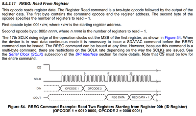

Your read/write byte code is probably not what you want. It's still unclear what you're trying to do with it. Use HAL_SPI_TransmitReceive to write and read a byte. To read a register, you send 2 bytes and read 2 bytes. Maybe that's what you are trying to do? Perhaps explain and show what you're trying to do with the chip and how you're using SPI2_ReadWriteByte.
The polling for TXE and RXNE is unnecessary. Use the HAL functions. There are SPI examples to go off of in the CubeMX repository.
To read a register, set up a transfer of 3+ bytes with HAL_SPI_TransmitReceive. Refer to the datasheet for the protocol you should be using.

This is the code I read and write register
//读写多个寄存器
void ADS1292_WR_REGS(u8 reg,u8 len,u8 *data)
u8 i;
ADS_CS=0;
delay_us(1000);
ADS1292_SPI(reg);
delay_us(1000);
ADS1292_SPI(len-1);
if(reg&0x40) //写
for(i=0;i<len;i++)
delay_us(1000);
ADS1292_SPI(*data);
data++;
else //读
for(i=0;i<len;i++)
delay_us(1000);
*data = ADS1292_SPI(0);
data++;
delay_us(100);
ADS_CS=1;
//寄存器数组写入寄存器
u8 ADS1292_WRITE_REGBUFF(void)
u8 i,res=0;
u8 REG_Cache[12]; //存储寄存器数据
ADS1292_SET_REGBUFF();//设置寄存器数组
ADS1292_WR_REGS(WREG|CONFIG1,11,ADS1292_REG+1);//数组变量写入寄存器
delay_ms(10);
ADS1292_WR_REGS(RREG|ID,12,REG_Cache);//读寄存器
delay_ms(10);
for(i=0;i<12;i++ ) //检查寄存器
printf("Write: 0x%02X, Read: 0x%02X\r\n", ADS1292_REG[i], REG_Cache[i]);
if(ADS1292_REG[i] != REG_Cache[i])
if(i!= 0 && i!=8 && i != 11) //0 8 和11是ID 导联脱落和GPIO相关
res=1;
else
continue;
return res;
}you can see that there 3+ bytes are transferred when I write or read registers.The problem exists in the ADS1292_SPI(0),
