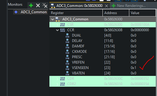

2021-11-22 7:03 AM
Yes, it was disabled. Now I enable it, by this line:
LL_ADC_SetCommonPathInternalCh(__LL_ADC_COMMON_INSTANCE(ADC3), LL_ADC_PATH_INTERNAL_TEMPSENSOR);
But I am not sure, that measure adc3 is fine. I'll try to do some measurements.:thumbs_up:

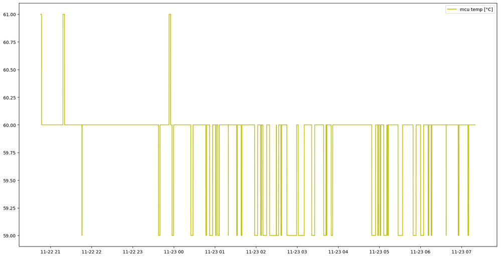

2021-11-22 7:48 AM
I started measuring. I measured for about 15 minutes. It looks good. Tomorrow I will continue.
@Gwenole BROCHARD Thank you for your advice.
2021-11-22 10:27 PM
I measured the temperature on the MCU for about 8 hours. It fluctuated within 2 ° C. I think that's good. With the help of @Gwenole BROCHARD there are source codes.

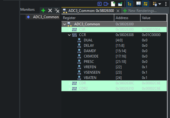

}2021-11-23 3:28 AM
So today I added another channel. And I think adc is working badly in my setup.
Here is complete code:

I'm approaching a solution. In some pdf I read about DCache. So I tried to update my code:
SCB_InvalidateDCache_by_Addr((uint32_t*) tempSensor, (uint32_t) (sizeof(tempSensor) / sizeof(uint16_t)));
UartPrint("TEMP=%d; PF10=%d; VREF=%d", GetMCUTemperature(), GetPF10Voltage(), GetVrefVoltage
// Using function for read temps and voltages
uint32_t GetMCUTemperature(void) {
return __LL_ADC_CALC_TEMPERATURE(3300, tempSensor[0], LL_ADC_RESOLUTION_16B);
uint32_t GetPF10Voltage(void) {
return __LL_ADC_CALC_DATA_TO_VOLTAGE(3300, tempSensor[1], LL_ADC_RESOLUTION_16B);
uint32_t GetVrefVoltage(void) {
return __LL_ADC_CALC_DATA_TO_VOLTAGE(3300, tempSensor[2], LL_ADC_RESOLUTION_16B);
}I used a freezer before starting the MCU. Now I have a problem with the PF10 value. This value is not measured.
The time in ms is given in parentheses.
[02011] TEMP=24; PF10=580; VREF=1269
[03016] TEMP=27; PF10=598; VREF=1268
[04021] TEMP=28; PF10=591; VREF=1268
[05026] TEMP=27; PF10=578; VREF=1269
[06031] TEMP=29; PF10=593; VREF=1269
[07036] TEMP=31; PF10=571; VREF=1269
[08041] TEMP=34; PF10=587; VREF=1269
[09046] TEMP=37; PF10=571; VREF=1270
[10051] TEMP=40; PF10=570; VREF=1269
[11056] TEMP=42; PF10=606; VREF=1271
[12061] TEMP=44; PF10=609; VREF=1270
[13066] TEMP=45; PF10=605; VREF=1271
[14071] TEMP=46; PF10=605; VREF=1270
[15076] TEMP=48; PF10=623; VREF=1270
[16081] TEMP=48; PF10=617; VREF=1270
[17086] TEMP=49; PF10=626; VREF=1269
[18091] TEMP=49; PF10=635; VREF=1271
[19096] TEMP=49; PF10=634; VREF=1271
[20101] TEMP=51; PF10=612; VREF=1270
[21106] TEMP=51; PF10=611; VREF=1270
[22111] TEMP=51; PF10=604; VREF=1270
[23116] TEMP=52; PF10=612; VREF=1270
[24121] TEMP=52; PF10=614; VREF=1270
[25126] TEMP=52; PF10=620; VREF=1271Here is my init ADC
