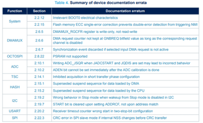

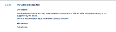

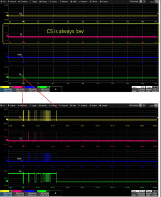

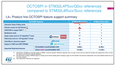

Hi,I work with a development team that is developing a product that has a STM32L4S9 MCU and a IS66WVH8M8ALL-100 HyperBus PSRAM.Recently, we found in the STM32L4 Errata that actually this MCU does not support PSRAM. We noticed that the self-refresh wa...
