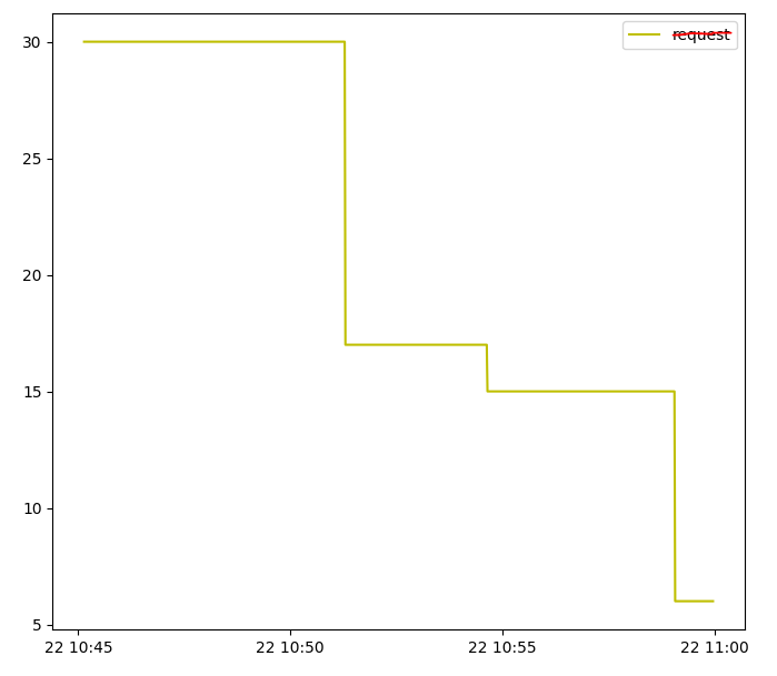

I reduced the resolution from 16b to 12b. And I let the temperature work out for a while. Here is the chart. It can be seen that it is completely wrong. I have a PCB in the office, where the temperature is about 24 deg.
uint32_t temp;
if (adc_flag >= 1){
adc_flag = 0;
if (dma_flag == 1){
temp = __LL_ADC_CALC_TEMPERATURE(VDD_VALUE, tempSensor[0], LL_ADC_RESOLUTION_12B);
UARTPrint("dma=%d, tempVal=0x%02x, temp=%d", dma_flag, tempSensor[0], temp);
dma_flag = 0;
}Figure chart: yellow is temperature in degree.

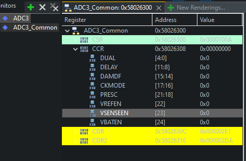

On other hand, can you confirm that bit TSEN is set to 1 ? It's located in ADC3_CCr register bit 23.
2021-11-22 6:49 AM

I'm sorry I took the wrong reference manual...Sampling time doesn't need to be change...
Try to force this bit just before starting your ADC and see if there is any change. It seems that the TempSensor is not enable.
