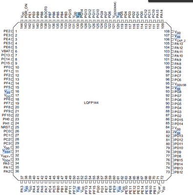

2024-10-15 12:22 PM
Beside the VDDSDMMC float, I don't understand why measure resistance for GND is like floating, You may need check pin 130 GND.
2024-10-15 12:35 PM
Another interesting observation. Schematic only shows one VSS pin connected, ther should be 10.
2024-10-15 12:41 PM
Hello @Chris21, all 10 pins are connected at the top of the MCU and then given to a single VDD supply, isn't it correct?
2024-10-15 12:44 PM
Yes, for the VDDs, but there are also the VSSs, all of them should be connected to GND.
