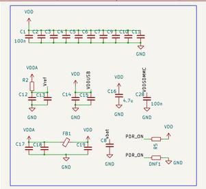

2024-10-15 11:51 AM
This seems very likely to be involved:
"The VDDSDMMC is an independent power supply for SDMMC2 peripheral IOs (PD6, PD7,
PG9..12). It can be connected either to V DD or an external independent power supply."

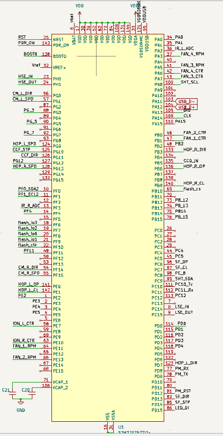

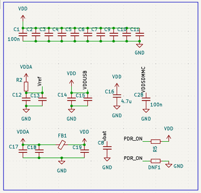

2024-10-14 10:43 PM
Hi @Andrew Neil , please find the schematic
I am able to Program the board,
GPIO Clock are defined (generated by Cube MX) properly, I am able to use all pins other than the 5 mentioned above.

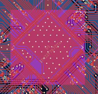

There is no extra component between the Pins and the connector and the length of each trace is also less than 6 to 7 cms. There is proper connectivity between the MCU pins and the connector Pads and Infinite DC Resistance between the MCU Pins and VCC, also between MCU Pins and GND
Surprisingly all 5 pins that don't work are connected between C28 and C6

That's not a schematic - it doesn't show what is actually connected to the processor pins
2024-10-15 2:32 AM - edited 2024-10-16 12:39 AM
@Andrew Neil Please find the required schematic parts for complete reference
. There is nothing between the MCU pin and the connector

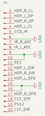

2024-10-15 8:51 AM
So all these 5 pins are connected directly to the connector.
1) Have you removed the connector and then tested the GPIOs ?
2) Maybe the board / connector had some ESD stress? Was it assembled / used in an ESD-safe environment?
3) Do you have another board to check?
2024-10-15 11:32 AM
You need provide 1.8 v or 3.3v to vddsdmmc pin 132?
2024-10-15 11:33 AM
Pin 121
2024-10-15 11:45 AM
Hello @LCE
1) Yes all these 5 pins are directly connected to the connector
2) Yes, it was assembled in an ESD safe environment
3) I soldered a new board with just the clock ckt, programming ckt, MCU and the capacitors needed to run and checked the output at the solder pads of the connector. Same Result
