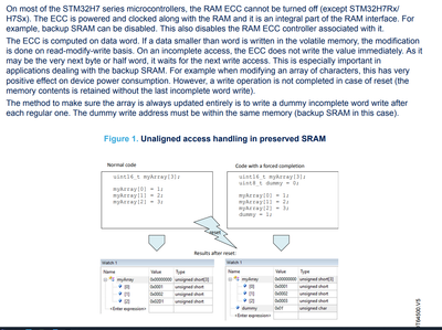

And it's a behavior caused by the ECC controller. In fact all write access go through ECC controller before to be written in the RAM. In your case, when you write the last byte and you reset the MCU, that byte still in the ECC controller and didn't reach the memory. As a workaround, after writing the last byte, do a dummy byte write to the memory. Please, refer to the AN5342 "How to use error correction code (ECC) management for internal memories
protection on STM32 MCUs" / Page 17:
This is how I worked around the behavior:
#define ITCM_BASE_ADDRESS 0x0
#define PATTERN 0x55
#define ITCM_LAST_BYTE_ADDRESS 0xFFFF
uint8_t *Buffer = NULL;
uint8_t Button_pressed = 0;
int main(void)
/* USER CODE BEGIN 1 */
/* USER CODE END 1 */
HAL_Init();
/* USER CODE BEGIN Init */
Buffer = (uint8_t*)ITCM_BASE_ADDRESS;
/* USER CODE END Init */
SystemClock_Config();
/* USER CODE BEGIN SysInit */
/* USER CODE END SysInit */
MX_GPIO_Init();
/* USER CODE BEGIN 2 */
/* USER CODE END 2 */
/* Infinite loop */
/* USER CODE BEGIN WHILE */
while (1)
if(Button_pressed == 1)
for(uint32_t i = 0; i<16; i++)
*(Buffer+i) = PATTERN;
*(uint8_t*)ITCM_LAST_BYTE_ADDRESS = 0; // Dummy write after an effective last byte write
NVIC_SystemReset();
/* USER CODE END WHILE */
/* USER CODE BEGIN 3 */
/* USER CODE END 3 */
void HAL_GPIO_EXTI_Callback(uint16_t GPIO_Pin)
if (GPIO_Pin == USER_BUTTON_Pin)
/* Toggle LED1 */
Button_pressed = 1;
Hope it does answer your question.
