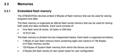

2023-12-06 8:17 PM
Page 25 says 2KB of user option bytes. Can this be used in someway? I couldn't find memory map address or APIs regarding this.
2023-12-07 6:38 AM
No, they can't be used and are not user accessible. The datasheet should be changed as it's misleading.
