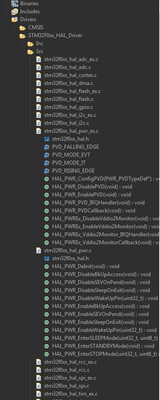

so for the ..PWREx... look in the HAL driver, what functions are there - for your chip !
Maybe it has other name or this chip dont have it at all...
here, you can see, whats in the driver:
To know, whether USB is "ON" , look in debug at the "SFR" , then registers for USB , and see, what is there .
So you can find out, whats wrong; just read in rm, what should be in registers / their meaning.
