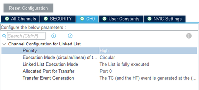

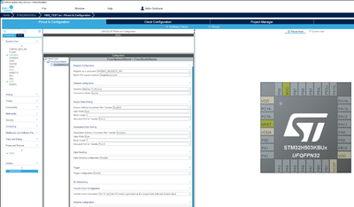

2024-02-23 8:21 AM
hi, i just had a similar problem and i managed to get something togather.
its reading the temperature sensor and the adc vref with the GPDMA in circular mode.
it seems that cube MX is not generating the node init at all on the H503 and on the H563 it is missing the "LL_DMA_ConfigLinkUpdate"

Could you please share an .ioc file that reproduces the issue from CubeMX side?
Thank you!
2024-02-26 3:14 AM
hi, the H503_TEST.ioc file is in the above attached H503_TEST.rar file.
to complete the list of problems that occur (for me) with that adc to dma stuff:
so it only generates the DMA_InitLinkedListStruct.
(with the H563) it it does generate the nodeconfig and the Node_GPDMA1_Channel0 init.
the GPDMA node should be initialised as static.. it works in the code i posted, but in my main project where i do more then just ADC to DMA the ram gets changed and as the GPDMA reads the node continuous it must stay what it is.
i think thats it so far

After more discussion with the CubeMX dev team, the points 2 and 3 are not really issues,
in fact, to configure the GPDMA tabs, you have to do it in utilities as shown here:
a file named linkedlist.c will be automatically generated and you won't need to manually add the LL_DMA_ConfigLinkUpdate or any other other configuration!
Sorry for the misunderstanding, I hope it's more clear now!
