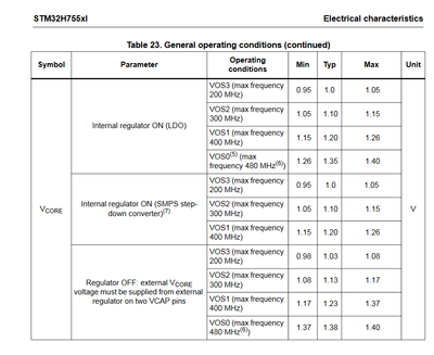

- Measured voltage across VCAP is 0.93-0.99V.

0.99V would be ok, on VOS3 / max. 200M , setting.
