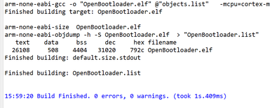

I suggest using the Example Selector within STM32CubeMX to choose the OpenBooloader example for the C0 series. It compiles without errors.
No doubt you are missing some configuration #defines somewhere.
