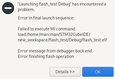

After successfully programming sector 7 I cannot flash a new application to my board, instead I am met with :
Error: ST-LINK error (DEV_TARGET_NOT_HALTED)
I can flash new code after a mass erase with cube programmer but this shouldn't be necessary.

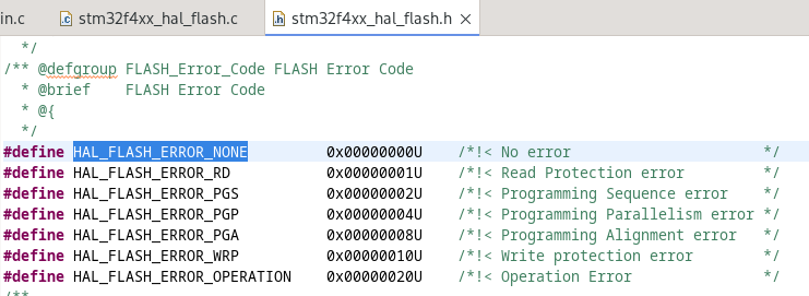

printf("Flash error : %lu\r\n", HAL_FLASH_GetError());

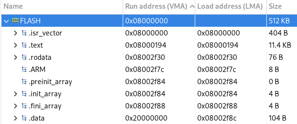

Here is the layout in memory of my application :
Like I said, there isn't anything here that be affected with me erasing sector 7.

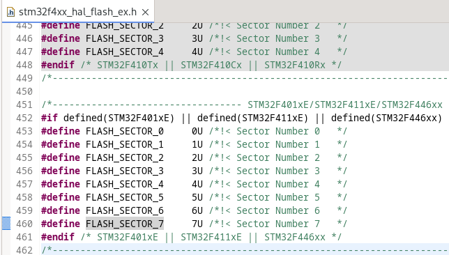

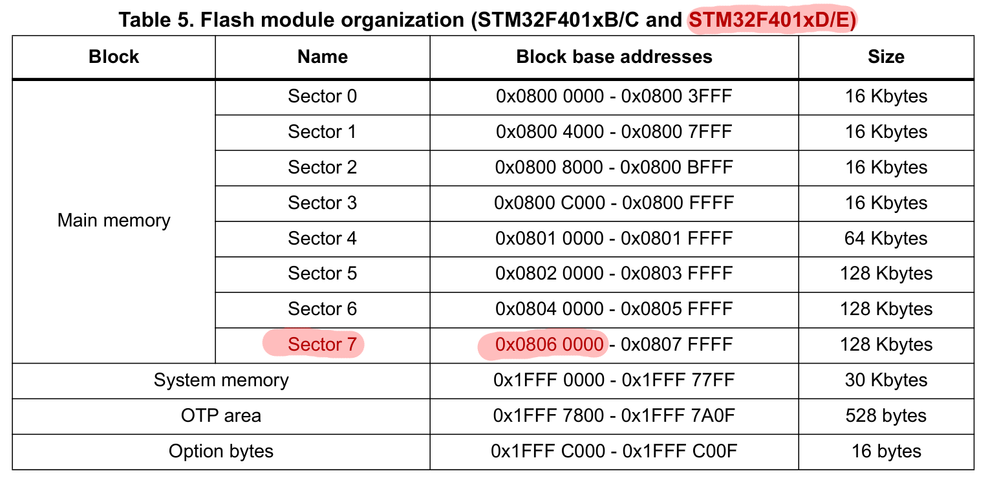

What is the address/value of FLASH_SECTOR_7 in this context?
The F401RE has 512 KB of FLASH
Is "STM32F401xE" defined on the command line? ie building for right part
Not sure if you have other code dependencies for data in this region, or disabling SWD/JTAG or PA13/PA14 pins

The address of FLASH_SECTOR_7 is 0x08060000.
