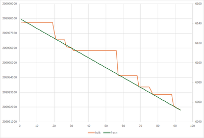

I did an experiment.
Starting from HCLK=210Mhz (HSE=16,M=15,N=393, FRACT=6144, P=2), every 16s I am decreasing FRACN (green line) and start collecting HCLK measurement every second (orange line).
With FRACTdelta=65Hz, every change of FRACT shall result in 65Hz decrease.
here are the results:
For the whole test (93 measurements, 24min of test) we see decrease of .... 5945Hz which means in average 63.92Hz per FRACN step. But, as you can see, PLL response is not following the FRACN setting properly.

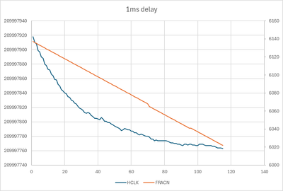

Not in product documentation, but in the HAL sources one can find clue that:
„Wait at least 2 CK_REF (PLL1 input source divided by M) period to make sure next latched value will be taken into account.” - apparently HAL designers are using completly other documntation knon to public.
With my setup it is ~3us thus I embedded 1ms delay:
No rapid changes, however curve does not comply to the PLL VCOout equation from RM492

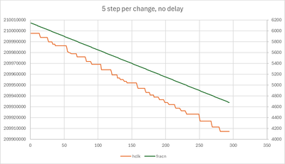

Next test is with changing NFrac by 5 every 16s. WIth no delay , i.e. very short FRACEN pulse.
Some hiccups are visible but the overall PLL response in linear.
To sum up, indeeed the delay is needed, but  should it matter if this is 3us or 1ms? Especially that setting FRACEN does not switch PLL to integral mode, one must still  latch 0 in SH_REG.
This implies that after setting FRACEN back to 1, and waiting for PLL1RDY to became 1, I should be able to safely set FRACEN=0, to create "long delay" before next PLL tuning session happens.

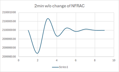

But there is more.. Here is a chart started at the moment, HSE correction achieved +/-1ppm thus FRACR is not changed anymore. But there is still some very slow osculation visible over 2min period of time (measurements taken every 15s as averages)
Will appreciate technical info how RCC PLL really works, what are the other important aspects that are not documented in RM? :)
