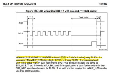

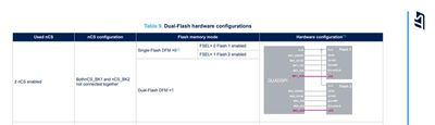

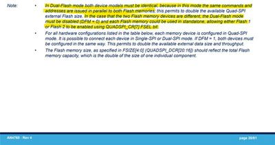

2025-02-11 1:19 AM - edited 2025-02-11 1:20 AM
Hello @JTse.1;
For dual flash mode DFM=1, both devices must be identical, because in this mode the same commands and addresses are issued in parallel to both memories.
Also, it’s possible to connect two different memories. In this case, the DFM must be set to 0 and the FSEL bit in QUADSPI_CR can be used to select FLASH1 or FLASH2.
For more information, I recommend you to look at AN4760 and RM0433.
Note that for this configuration both chip select not connected together.
