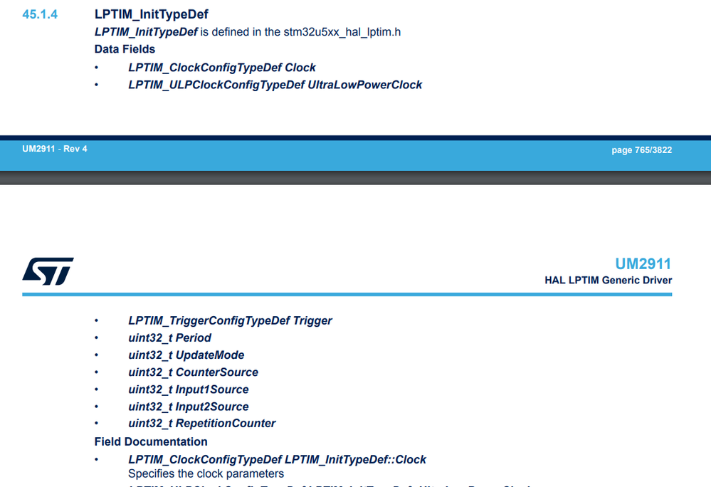

You can find descriptions of the Init Structure in the HAL User Manual - UM2911:
The same information also appears in the comments in the source files - use the IDE's 'Go To Definition' feature...
