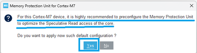

For the MPU: for Cortex-M7 to prevent the speculative access and mainly for the external unused memories, it's recommended to disable the access to these memory regions using the MPU.
So in CubeMx, enable the default MPU settings by clicking yes on this pop up:
The explanation of this configuration explained in this thread.

2025-02-11 3:44 AM - edited 2025-02-11 3:50 AM
