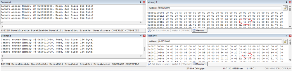

Hello, well I have some array of uint16_t data with is contains 50 records. If I truing to write it to the flash memory it looks like it have done an then if I write again, the HEX data in debug mode memory is randombly chenging. Ideally Firstly I need read data from flash(after power off) and write to array, on another iteration if data in array != data in flash, then overwrite flash. To put it sumply this is for manage/store a data in flash. Please help me.

Pretty sure the sizeof() here doesn't know the array size
Couldn't you just cast the array directly?
2023-03-19 5:50 AM
sizeof() is the size in bytes, if you multiply it and do a byte copy you will overflow the buffer.
2023-03-19 6:04 AM
Yes, thank you for your yesterday code. Even your original code:
* @brief Gets the page of a given address

2023-03-19 6:13 AM
No, this reads 200 bytes, and overflows
printf("%d\n", sizeof(Holding_Registers_Database_test) * sizeof(uint16_t) );
2023-03-19 6:15 AM
Also, if you use a structure/pointer you can read the values directly from the flash
2023-03-19 6:20 AM
