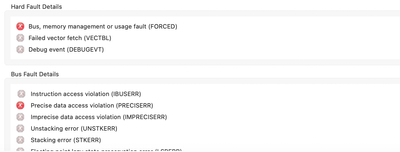

I'm trying to write a float value into my STM32H743VIT6 flash memory, bit it jumps straight to the HardFaultHandler and I cannot understand why...

What is the value of ALTITUDE_MAX_ADDRESS? It needs to be 256-bit aligned.
Step through the code, which line does it go to a hard fault?

2025-02-14 5:49 PM - edited 2025-02-14 5:52 PM
Hello TDK,
Finally I found the solution.
Actually, the Both functions seems good.
the 3 defines that i created during the issue were the following :
#define ALTITUDE_MAX_ADDRESS 0x081E0000U
#define FLASH_BANK FLASH_BANK_1
#define VOLTAGE_RANGE FLASH_VOLTAGE_RANGE_3
The HardFaultHandler issue occurred during the Retrieve_AltitudeMax function.
I just changed the FLASH_BANK value to FLASH_BANK_2 and it solved the issue. Can you tell me if the two functions are optimized or if i can do better?
Maybe it's not a smart question, but why this change solved the issue ? And why on this particular H7 model, there's not really explicit informations on the flash addresses on the datasheet? Does this apply on all H7 MCUs?

2025-02-15 9:32 AM - edited 2025-02-15 9:34 AM
Of course. Because the address 0x081E0000 belongs to bank2.
??? The addresses of all banks and sectors are documented, either in DS or RM. And they are not hard to calculate.
