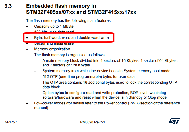

The RM does say that byte, half-word (16 bits?) word (32 bits?) and double-word (64 bits?) should all be possible:

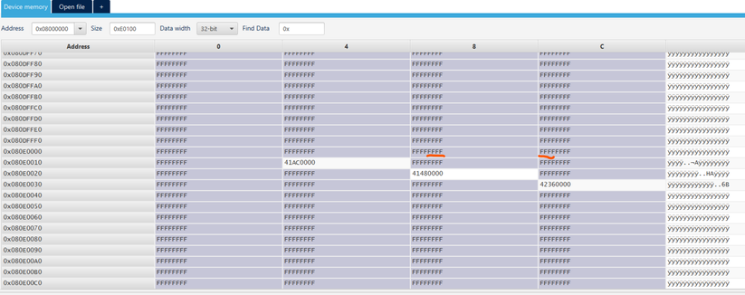

@Andrew Neil Yes you can still write as a word or any of the other writes, but it still has to align to within a column. Right now the OP is trying to write part of his float in column 8 and C when he use decimal 10, 20, 30, etc. In this case for decimal 10, it fails to write anything and still shows 0xFFFFFFFF

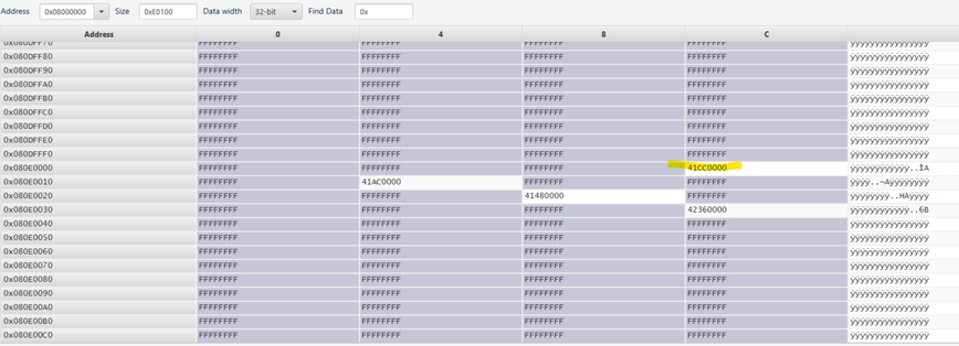

Here is when writing at SECTOR_11_START + 12 which is now aligned in a column and not overlapping into another column. So in this case it does write the value in flash correctly.
I originally thought the OP was trying to increment the address so it would align like this. So I told him to use hex 0x10, 0x20 and so on
